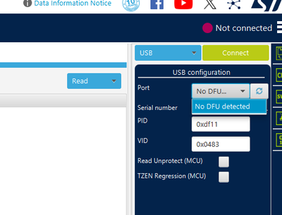

or in the stm32cubeProgrammer i get:
I then tried setting the boot0 to high and doing the reset sequence, and I got the usb connected and did a full chip erase as said.
After that I was able to connect the stm32 in the cubeprogrammer but not in the ide to run my code. In the IDE I got this then i reprogrammed it and it got as prior:

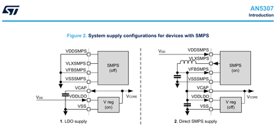

2025-06-08 1:47 PM
> PWR_DIRECT_SMPS_SUPPLY
You don't have any SMPS circuitry hooked up, so this power configuration is not valid. Switch to the LDO supply in RCC tab, Power Parameters, PWR_LDO_SUPPLY.
The chip is responding and when the program is read, it crashes because the power settings are invalid.
Unclear if you absolutely need VFBSMPS grounded, but if it doesn't work, that'd be the next thing I'd correct.
