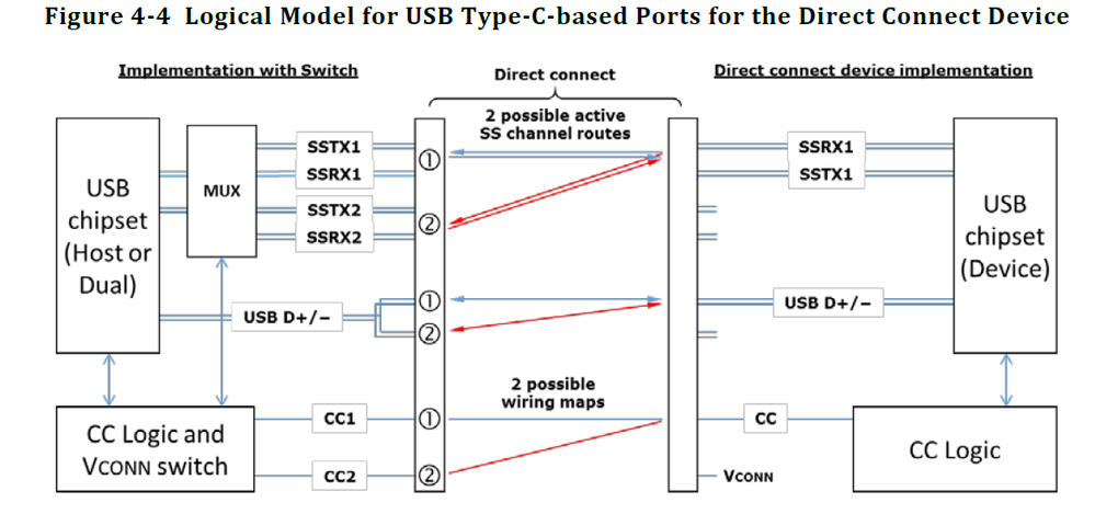

From USB C specifications:
For the device, the location of the USB SuperSpeed data bus, USB 2.0 data bus, CC and VCONN pins are fixed by design. Given that the device pin locations are fixed, only two possible connected states exist when viewed by the host.
In the case of a USB 2.0 device, using a USB Type C connector only CC1 must be connected to the pull down resistor. VCONN (CC2) can be left floating.

Hello @paolo239955_stm1_stmicro_com
No you must drive both CC pins with one different Rd pull down resistor. Because you don't know how the cable will be plugged. And in case of EMC (Electonically Marked Cable) only one CC line is going from one end to the other.
