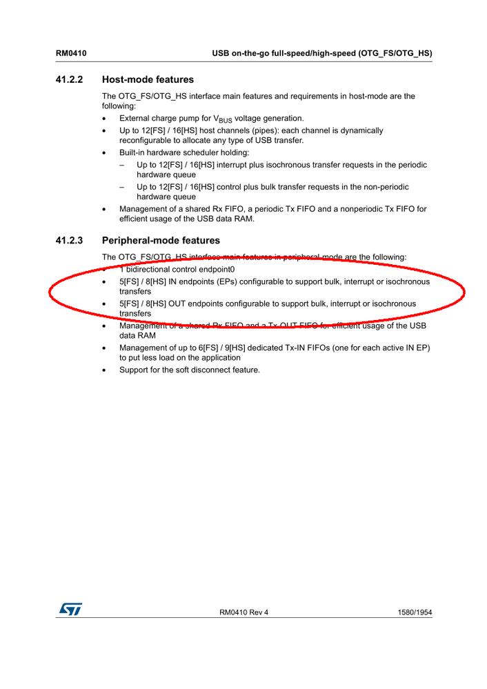

2021-06-21 3:32 AM
The number of endpoints depends on whether you are using OTG_FS or OTG_HS (regardless of the actual PHY/speed used).
