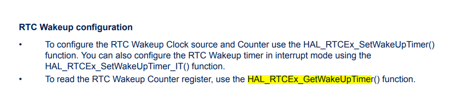

Hello @jinyi7016
The function HAL_RTCEx_GetWakeUpTimer() get just the value of WUTR register previously set with the function HAL_RTCEx_SetWakeUpTimer_IT().
Please refer to the UM174 more details.

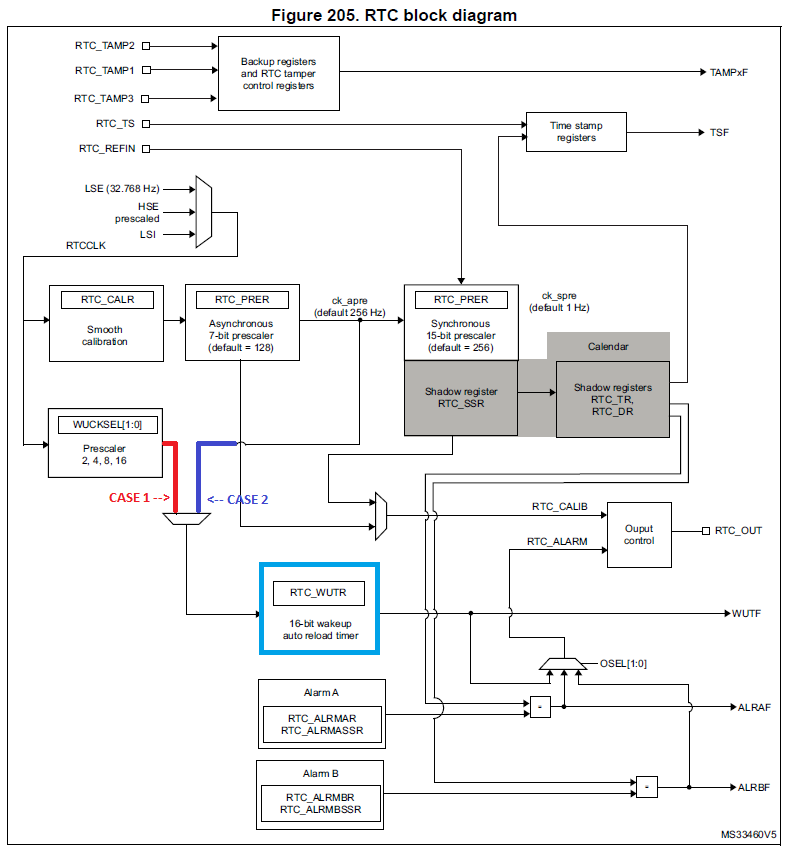

Hi @jinyi7016,
Here is a solution. However, it supposes you are not using the RTC Calendar, only the RTC WUT (Wake-Up Timer).
To better illustrate it, I join the figure below adapted from the reference manual of the STM32L0 series. The idea is the following:
There are two cases:
Let's dive into the details and steps:
Make the RTC_SSR register synchronous with the WUT counter. For this:
Now, to estimate the current value in the WUT counter:
I hope this helps.
