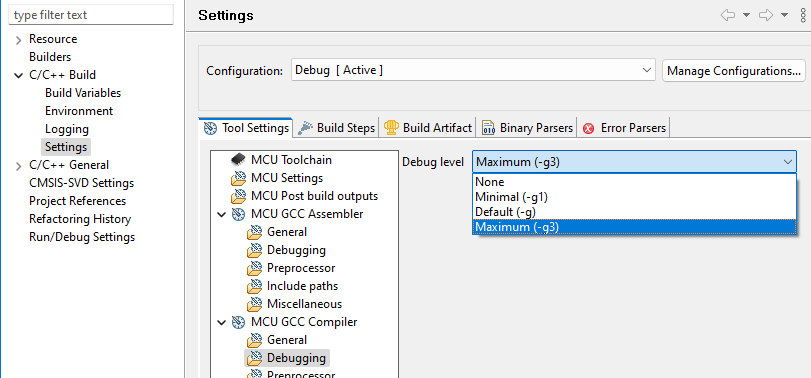

If Debug level is different of "None" then these roots filenames are in rom flash.
The only solution is the "None" choice to have any root filename.

What do you mean by, "Debug level" ?
2024-09-23 7:53 AM
Yes "debug level".
I looked this on STM32G0 and stm32G4. not on STM32F0.
2024-09-23 7:57 AM
Ah - this:
I'll bet that 'None' causes USE_FULL_ASSERT to be not defined.
