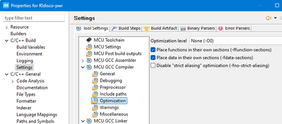

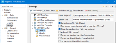

2024-09-23 2:01 AM - edited 2024-09-23 2:02 AM
What optimisation level are you using?
By default, 'discard unused sections' should be enabled - so unused functions shouldn't appear in the final image.

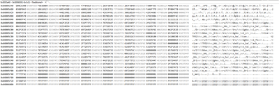

2024-09-23 2:20 AM
I have this links in Hex file
2024-09-23 2:26 AM
How do you determine that they are actually in the Hex file?
Again, the Hex file contains no symbol information - it is purely code - so where are you seeing that?
2024-09-23 2:47 AM
This is my hex file for my application.
You look the links file at the end file Hex
