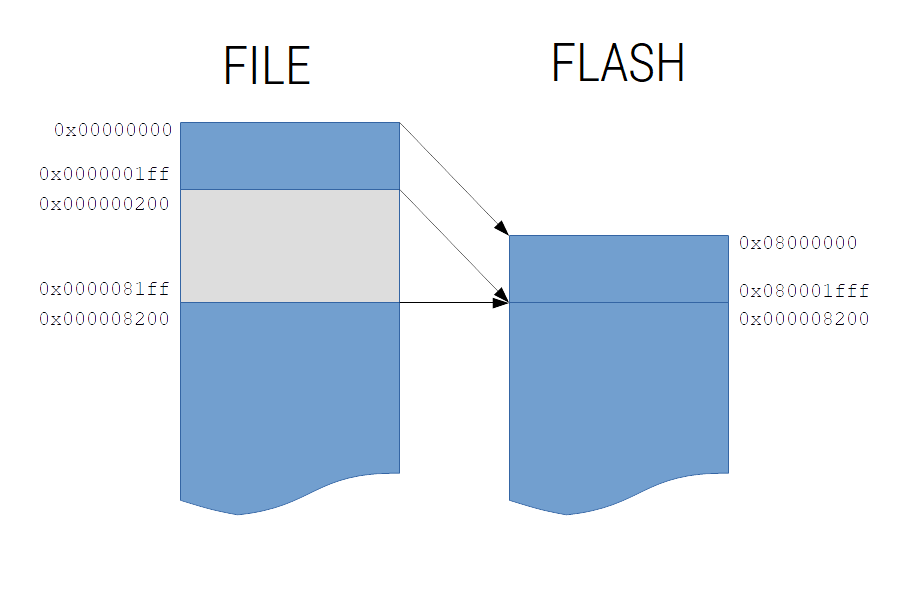

It turns out that a huge great chunk of the .bin file is surgically removed before being sent to flash (see the picture) as part of a preprocessing step.
I'm surmising that the original firmware programmer didn't know how to compile his code for address 0x08008000 so he compiled for 0x08000000 and managed to convince the linker to put in 0x8000 unused bytes straight after the vector table. The bootloa
The bootloader itself is basically ok, but my problem now is that, for other reasons, I have to use the exact same preprocessor which means that I'm going to have to find a way to duplicate the same .bin file layout. Do you have any ideas on that one?

Ok, so it seems to me that what I need in the .bin file is 512 bytes of vector table at 0x08000000 to 0x080001ff, followed by 0x8000 bytes of space from 0x08000200 to 0x080081ff, followed by the rest of the code from 0x08008200, with the "Reset_Handler" being the first part of the rest of the code.
The vector table will end up being flashed at 0x08008000 to 0x080081ff and the rest of the code exactly where it expected to be.
I can see why your setting the origin back to 0x08000000, but I'm a bit lost with the sections and so on. Is that what your mod is doing?
