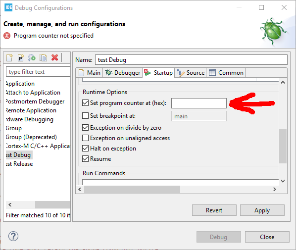

2020-02-18 5:13 AM
Start the bootloader from the debugger.
Find the debugger reset vector, which is stored at 0x08000004, and use the value found there as the start address in the debug configuration dialog (hope it's there in system workbench too).
Then put a breakpoint on the application reset handler, main, etc to see how far it gets.
