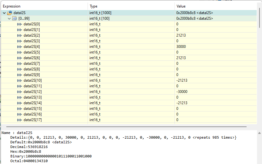

2021-12-10 6:37 AM
Show here your dataI2S array values for example first ten values as in memory debuger screenshot...

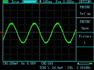

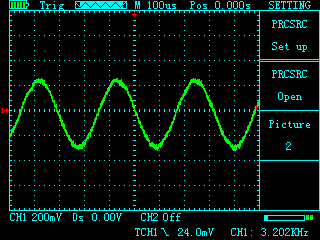

Here are screenshots of the oscilloscope for both sides L and R:
2021-12-13 5:03 AM
for output same signals need data be equal [0]=[1] [2]=[3]
and too need check BSP support for 16bit data
2021-12-16 5:39 PM
That’s exactly my point, one side has all zeros but it produces the same exact wave, just time shifted. And the HAL library asks for my data in a 16-bit buffer, so I am pretty sure that means it supports 16-bit data.
