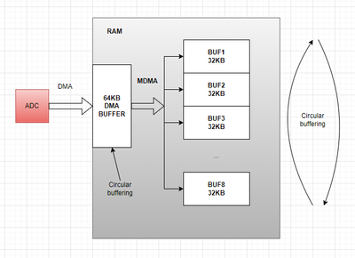

Hi All,
I am struggling with that the maximum DMA buffer size is 64KB. I am currently transferring the data from an ADC to the Buffer using DMA with circular buffering, but I would want the buffer to be around 200KB. I have heard that one can use MDMA to transfer the DMA buffer information to a bigger buffer. I have never used MDMA before, and there is little information online about how to use it in CubeIDE. If someone can help me to configure the MDMA/DMA to do this, and what functions to use it would be very helpful!

2023-10-25 5:20 AM
Like this

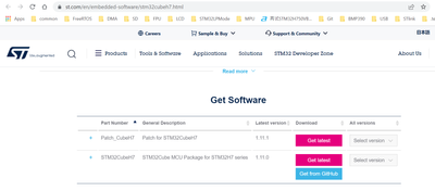

2023-11-01 2:54 AM
you can find the STM32 cube demos for MDMA on st.com, or can use Cube-MX to build MDMA function automatically.
for example, STM32H747 MCU has MDMA module, you can find "STM32H747", you can find it on st.com, then you can get the completely demo to how to use MDMA.
