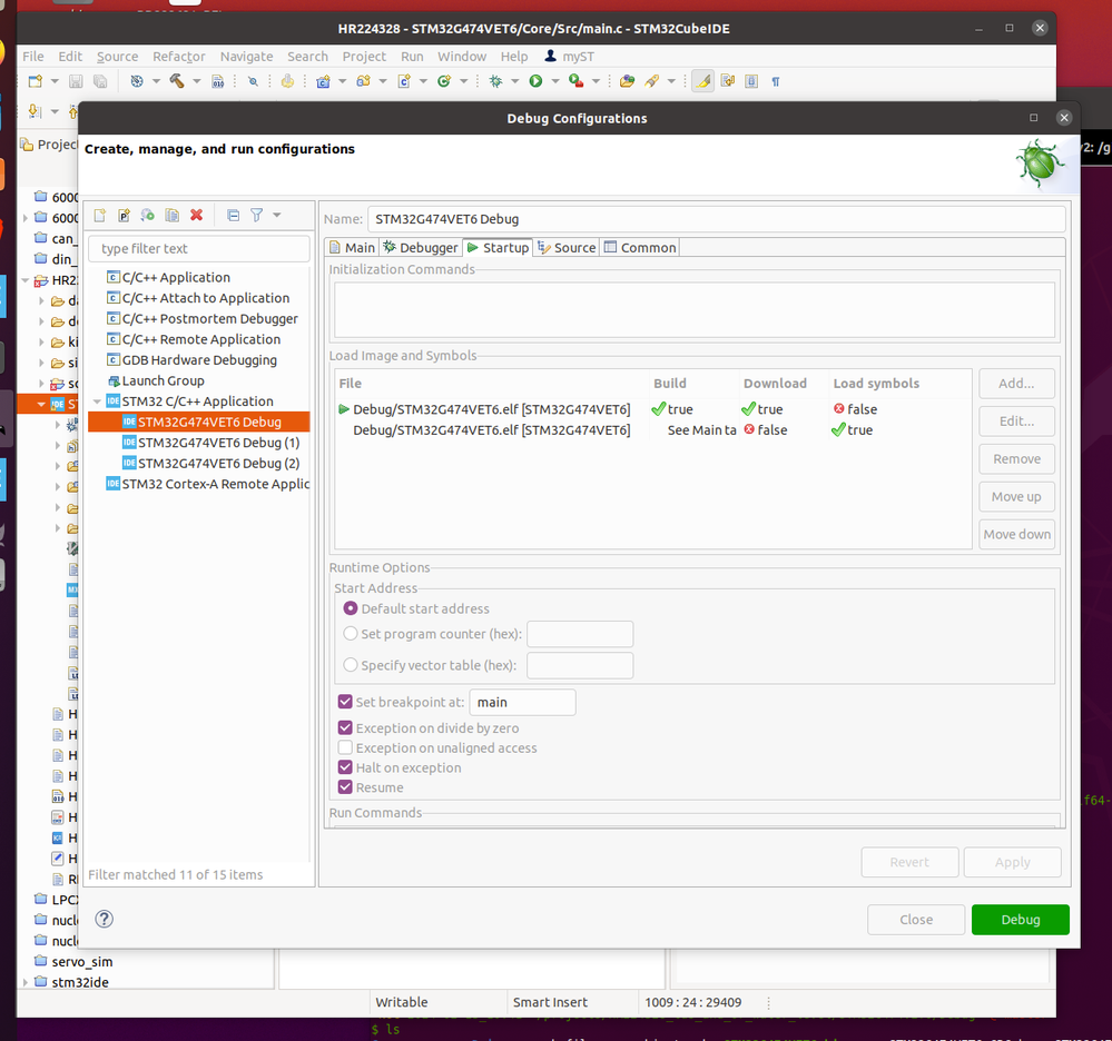

OK but we have scripts that post process the binary into hex files, using objcopy. This produces a hex file (useful for production later in the development stages) with a CRC32 in the final FLASH section
With the old STM IDE I used to be able to download the binary image from the hex file and the symbols from the elf. The new GUI does not seem to give the option of reading a hex file.
That way I could debug with a pre calculated CRC32 (and make sure the CRC32 parameters were producing the correct CRC32 variant b[byte-reversed, xor's with 0xFFFFFFFF are two examples of variants]).

STM32CubeIDE
Version: 1.13.2
Build: 18220_20230914_1601 (UTC)
(C) 2023 STMicroelectronics ALL RIGHTS RESERVED
The debug window (pic attached) only seems to offer elf or axf. I have even made the compiler produce .hex but this made no difference.

Thanks I tried this thinking that if there was a hex output from project properties it
would allow this in the debug window. After compiling successfully and creating a hex file
It does not seem to make any difference to the debug selector
though, only axf or elf files are offered.
In earlier version of the IDE this was possible.
