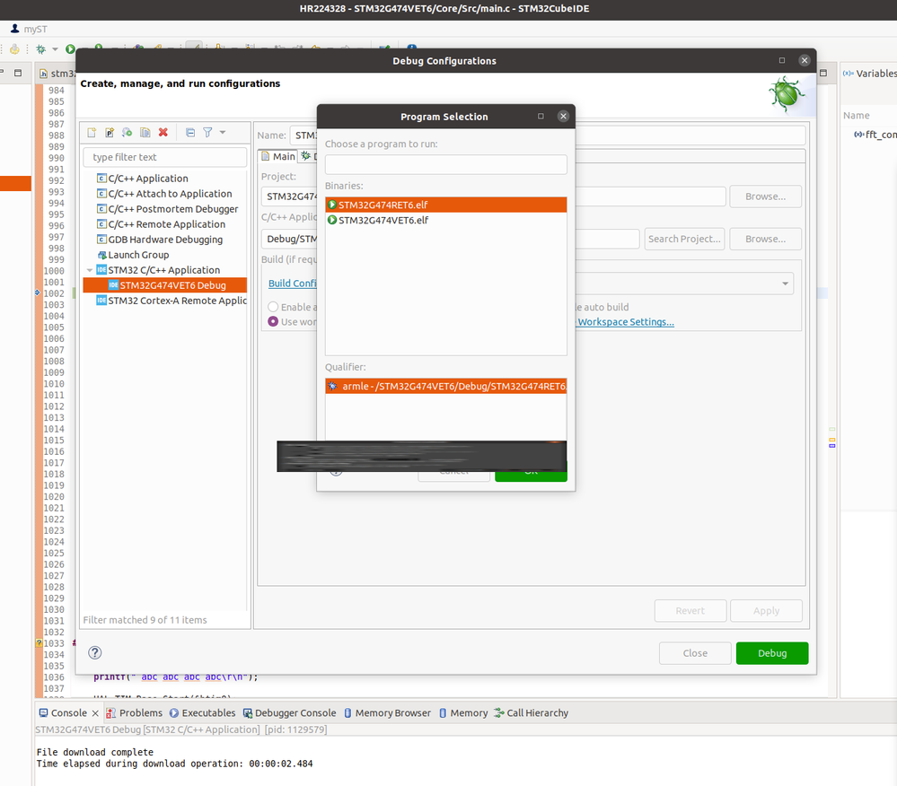

Exactly what I am trying to do. I have read in the binary modified it to contain a CRC32
and now want to read my modified hex file in, with the symbols coming from the
'elf' file. But the only file types I seem to be offered are elf and something called 'axf'.
I want to be able to use the hex file because that is what production get
2024-02-12 8:40 AM
me too. I know it used to read the hex file for the flash data and the lef file for the symbols. so you could debug the actual hex file that had , say, a CRC32 checksum in it.

2024-02-12 8:48 AM
It used to offer hex images, but now it only seems to offer the elf file

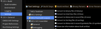

IDE -> project -> properties ->
in debug -> hex file

That's for INPUT to the DEBUGGER, you need options of OUTPUT from the LINKER
Could use OBJCOPY or FROMELF
