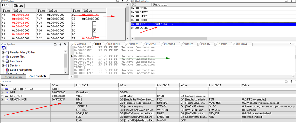

Moreover, can you send the callstack window in UDE when IVOR occurs (views-->call stack window) and flexcan MCR register value (views->sfr view-> right click->browse)?

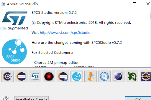

1. Version of SPC5studio

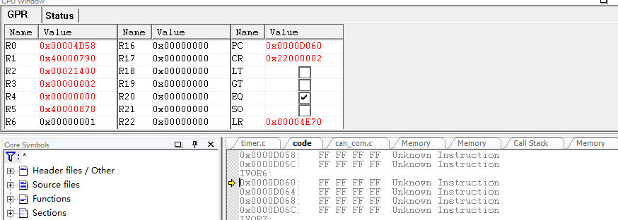

2. ivor6 but sometimes it seems to enter ivor1 after jump

I will try the second scheme?here is my callstack and flexcan MCR register.
