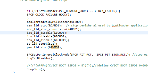

I think I have disabled the interrupts after

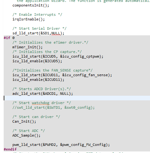

stopping peripherals?but it still entered the IVOR6, I can?t find where the problem is?here are my application code and the bootloader code? I copy the code from your answers?and is I don't init any
peripherals
in app? it can jump successfully? it is so weird. There are only peripherals of can and timer.

my idea is that there is some peripheral which is not correctly stopping and lead to an error when jumping.
we should understand which one is. could you try to enable one peripheral at a time and check when it does not work?
also, please try to set DRUN mode as last operation before jumping:
Regards,

Hello procolo:
Thank you for your tips. I have changed my code as your proposal,Then I initialized my peripheral one by one , and found it maybe the CAN does the effect, if there is only initialization and TX message, it is OK to jump, but if there are message for rx, the program enters IVOR6 even if I have stopped the CAN module.Do you have any opinion to solve this?
