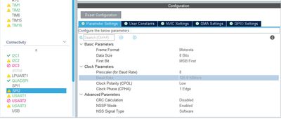

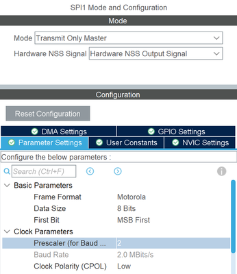

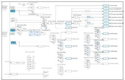

I’ve been referring to the RM0394 Reference Manual, particularly section 6.2 on Clocks (page 178), but I noticed it doesn’t specifically mention SPI. In my configuration, I’m unable to directly adjust the SPI clock. While I can reduce the clock frequencies for other peripherals like I2C, the SPI clock appears to be fixed and non-adjustable.
My primary goal is to reduce the CPU clock to the lowest possible value while ensuring the LCD screen operates within a suitable clock range. I attempted to lower the overall MCU clock to 1 MHz, but this significantly slowed down the screen refresh rate, making it less practical.

1. I mean no SPI clock is based on PCLK2 then in transfer time PCLK must be 2x SPI speed. After transfer can swith down...
2. Too NO.
3. Use partial update method for screen and switch to low power after transfer changes.
By energy law is irelevant if you use low SPI speed with low current long time vs high speed short time. Avoid animation at all.
