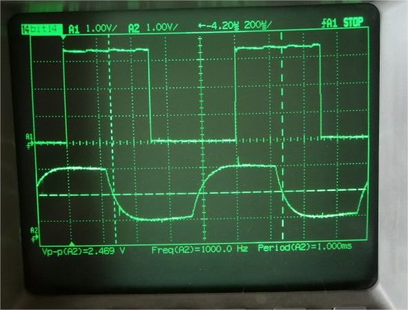

But I need to read out the data in the HAL_ADC_ConvCpltCallback Function, the DMA is firing twice...
void HAL_ADC_ConvCpltCallback(ADC_HandleTypeDef *hadc)
    if (hadc->Instance == ADC1)
dominik
Senior
The values are not really stable, but with a bigger sample time its better
sConfig.SamplingTime = ADC_SAMPLETIME_12CYCLES_5;
How I calculate the sample time for good results?

and in the ADC1_Read function I start the DMA again, its running now without problem, trigger source is OC event from Timer4, the GPIO toggle was to check the time when ADC conversion is finished
void ADC1_Read (void)
    ADC_Niveau.BoilerLow = ADC_Values[0];
    ADC_Niveau.BoilerHigh = ADC_Values[1];
    ADC_Niveau.TankHigh = ADC_Values[2];
    ADC_Niveau.TankUeberlauf = ADC_Values[3];
    //eud Test
    HAL_GPIO_TogglePin (Error_Reset_1_GPIO_Port, Error_Reset_1_Pin);
    HAL_ADC_Start_DMA(&hadc1, (uint32_t*)ADC_Values, 4);
Trigger for the ADC Event = CH1, CH2 = ADC to measure
