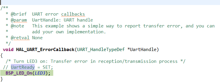

2021-03-18 5:30 AM
This error callback function is not getting called when we connect to PC. But we are getting during modem (UART based)communication only. Whats purpose of this callback ? Is there any configuration need to add ?

We have tried new interrupt based program and its working but we still see error and continuously UART error callback function (i.e. HAL_UART_ErrorCallback) getting called.
If this error is getting then we don't get any data in receive buffer. Please suggest us:
