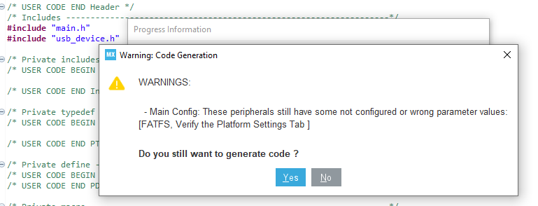

2022-10-04 5:32 AM
It returns the following error when trying to connect over CubeIDE
2022-10-04 5:33 AM
If you continue with "Yes", neither USB nor SD CARD works
