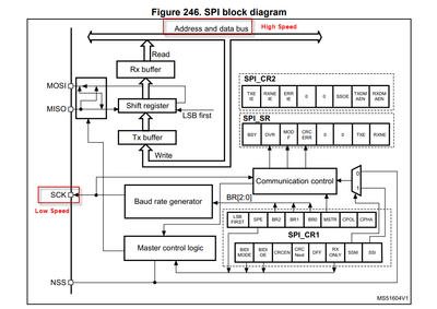

There is a STM32F407 on my board to configure and control the optical module. Also, STM32F407 use SPI to interface with CPU. STM32F407 work as SPI slave mode, and CPU work as master mode. Some protocol require one flow control byte in SPI timing, such as OIF protocol. My understanding is :
For read operation. After slave receive the operation code and address, slave need time to prepare data according to address then put the data into TX_Buffer. This all will be finished in the one clock period as below red mark shown. If slave can't finish the job in time, slave must inform to host through flow control byte .
My question is whether flow control byte is needed in the SPI frame for STM32F407?or it can mitigate this issue through reducing the SCK frequency, not through flow control byte?

Sorry that I confuse you. I only care about SPI interface between STM32F407 and CPU, and just mention the optical module. You can ignore optical module. Yes, for SPI interface between STM32F407 and CPU, STM32F407 work as slave mode and CPU work as master mode. My concern is that whether STM32F407 could handle data during one clock period? If not, flow control byte is needed or reduce the frequency of SCK for mitigating it?
First, the term "flow control" is a bit misleading, because it usually implies additional hardware signals. And this is not the case with SPI.
And I'm not sure what you mean with "clock period".
Most probably not a single SPI clock cycle, the MCU/CPU never sees that.
Received data are only visible after the scheduled reception. With "scheduled reception" means the configured size, which is either 8, 16 or 24 bits for the F407 (AFAIK). Only then the received value is transferred from the SPI hardware to the Rx register.
Looking at the transfer diagram in your initial post, I think the F407 cannot do that.
You know the command and 24-bit address only after the MCU has received them. The F407 can only satisfy the request after it decoded it, and fetched the values.
If the other side (CPU) immediately continues to clock in/out bytes at that point, there is no time to do that. Most probably the MCU has not even "seen" the received bytes yet.
Some for of "protocol flow control" is necessary.

This kind of flow control byte in the SPI frame is defined by OIF-CEI protocol, that server for interfacing with MCU in the optical module. It is in-band flow control means if MCU(work as slave mode) couldn't finish data process in one SCK cycle after it receive command and address byte. Before that, slave MCU need to agree with CPU or main-control unit how to interpret this byte, as below word shown:
0x00: ACK, slave MCU could handle this access, and next byte transmitted is data
0xFF: NACK, slave MCU couldn't handle current access, and next byte transmitted is flow control byte too.
I think speed of Bus is fast than SCK frequency. So, could reducing the frequency of SCK mitigate this issue?

@JieShen_Jason wrote:I think speed of Bus is fast than SCK frequency. So, could reducing the frequency of SCK mitigate this issue?
Again, you have this "flow control" mechanism defined - why not just use it?
