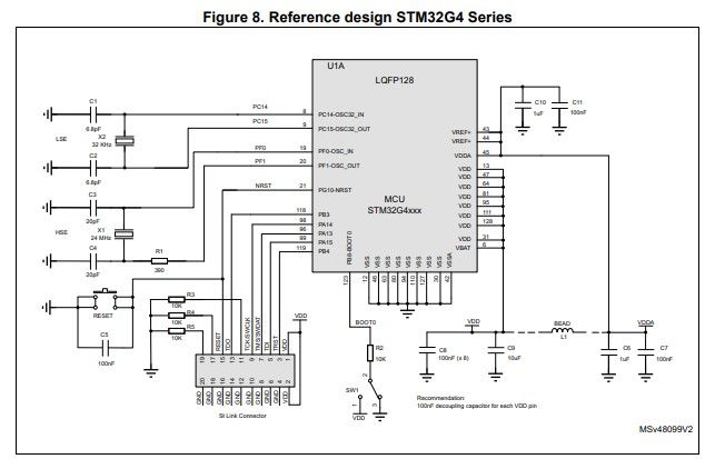

This is what I have so far: high quality pic of the schematics

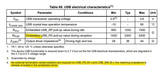

1) Pull up for DP
Back in the F1 boards I had to put a pull-up 1.5k resistor between DP and 3.3V, now it seems that the needed circuit is already provided inside the package. Si I can remove R1, R2 and R5. Is it correct or did I misunderstood it? What about the 2 cap (C13, C14)?

3) VREF pin usage
I can have this pin connected to VDDA or to an external source (plus 2 cap):
"If JP2 is closed then C10 and C11 doesn't have to be populated"
4) BOOT0 pin wiring
I think I should wire this pin to GND for normal operation and to 3.3V for uploading of new code. I think I would do it with a header-jumper but other suggestion (or correction) are welcomed
5) GND and AGND connection
I think that I would get different answer on this. I saw a lot of people making a single GND/AGND and also someone make a single point connection between them
I would like to share the schematics/board if you think it would be useful

> 1) Pull up for DP
You can remove everything on that line. If you want additional ESD protection, put a dedicated chip on the data lines for that. Take a look at AN4879.
> 3) VREF pin usage
Typically this is directly connected to VDDA. Same notes as in (5) below.
> 4) BOOT0 pin wiring
If you're programming over SWD, you can hook this straight to GND. Only reason you need to pull it up is to enable the system bootloader.
If you're not using the ADC/DAC or if you don't need more than about 10 bits of precision, it doesn't really matter how you ground AGND. I put a via to the ground plane right at the pin.

> 1) Pull up for DP
I removed all the resistors on the DM/DP lines but I keept the two capacitors, should I remove also them?
> 3) VREF pin usage
I would do as you suggest and I will keep the JP2 closed, also this is the same as the reference design from STM
> 4) BOOT0 pin wiring
I would mainly use the bootloader so I would need to switch in a simple way the BOOT0 pin
10 bits would be more than enough, I will be using the common GND
