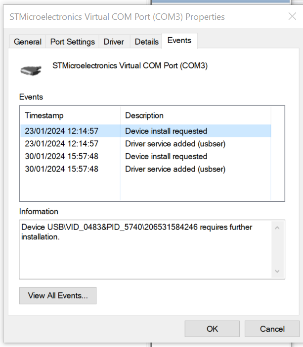

2024-01-30 8:14 AM
After looking at properties in devcie manager I'm wondering what this means.
I've run the installer downloaded from ST, so that's not it. Windows can't find a better driver.
