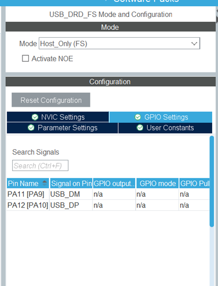

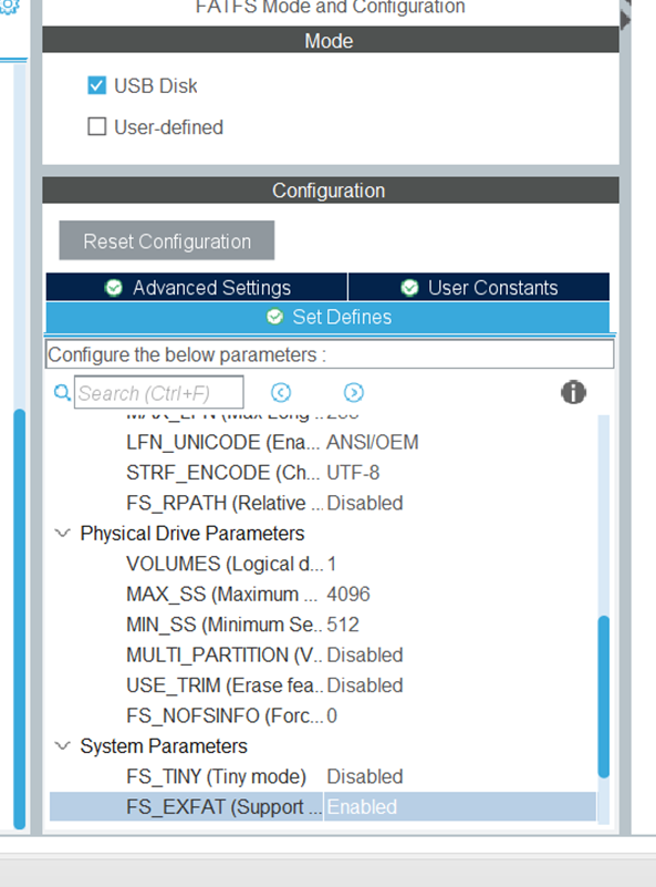

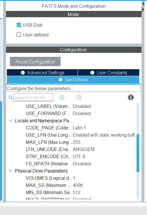

Sorry for bothering you guys again. I have tried to solve DISKIO error but everything is working fine. There are no errors. Can low heap size cause FR_DISK_ERR??
I am posting the code I wrote in "USB_host.c" and my settings which I am using:
Generally speaking GNU/GCC hides a lot of potential size issues with heap/stack
Some of the USB Driver Stack for devices used the heap.
FATFS can use the heap for things like long filenames, etc, check ff_conf.h
It can also use the stack for auto/local variables, I'd typical look for at least 1 or 2 KB
