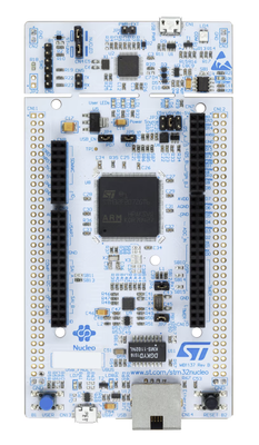

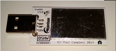

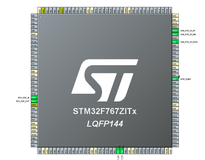

I have STM32 Nucleo F767ZI Board and OneRNG V3.0 by Moonbase. OneRNG is using USB Serial Protocol. When I connect OneRNG directly to PC through USB connector, open it's COM Port on Serial Monitor like Putty, send CMD "cmdO", it starts giving continuous stream of Random Numbers until I send "cmdo" to stop data stream reception. Now what I want is, instead of PC, I want use STM32 Nucleo F767ZI board with OneRNG using USB interface CDC VCP with Nucelo as Host and OneRNG as a device. OneRNG doesn't need any coding as it's already working with built-in firmware from the organization. I am providing below my OnrRNG, Nucleo board, CubeMX cobfiguration and main file, but I am unable to receive any data from OneRNG.

When I connect OneRNG to PC directly, a COM Port appears. On selecting that COM Port in any serial terminal, and when send cmd "cmdO", OneRNG starts giving random number continuously until I send a cmd "cmdo" to stop, during no transmission, led on OneRNG remains bright and as I transmit cmd, led gets dim and random data starts until send stop cmd and led again gets brighten.
But in my case with Nucleo board, on transmitting cmd, led doesn't get dim most probably cmd isn't received by OneRNG.
