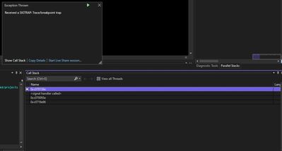

2025-09-05 9:42 AM
Here is the stack that is being shown when i do GET request:
Here is the mapping of the address to show the line number from where the error is triggering from:
using the arm-none-eabi-addr2line I have mapped these address to the line number
0xc070156e Function : HardFault_Handler, File: stm32h7xx_it.c Line: 94
0xc070093e Function : memcpy, File: ?, Line: ??
0xc0719e96 Function : _nx_crypto_sha256_update function, File: nx_crypto_sha2.c, Line: 268
> What memory addresses is the memcpy() acting on? Is it aligned?
Is there a better way to debug this ? and how to check if the memcpy() memory address is aligned ?
> The memcpy at the entry or exit?
Based on the line number, it is most probably the exit one.
> How are you allocating the memory being used to store structures?
Seems like this is being called by NetxDuo and is passed as a pointer are you saying I should track whether it is dynamically created ?
> Check alignment of context buffer. Is that also in SDRAM ?
I think it is aligned and not in SDRAM.
