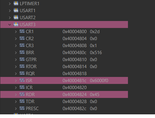

2025-01-25 4:46 AM - edited 2025-01-25 4:49 AM
Sir,
I went further into it I had monitored the RDR and it showed the received value correct.
I also monitored RXNE flag it was setting at 1 while receiving the first byte.
And also RXNEIE is 1. Interrupt routine should be called but it reset RXNE and debugger got lost, not executing anything.
I have checked NVIC in startup file all seems ok.
Yes Sir, Interrupt is enabled. I have introduced it also just before while loop.
HAL_NVIC_SetPriority(USART3_IRQn, 0, 0);
HAL_NVIC_EnableIRQ(USART3_IRQn); // Example for USART1
USART3->CR1 |= USART_CR1_RXNEIE; // Enable RX interrupt
Thanks,
