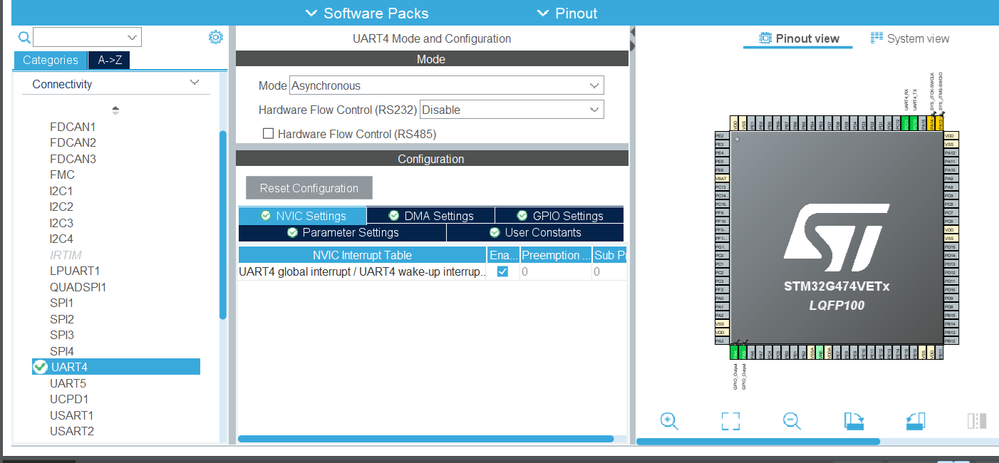

You still haven't indicated if you enabled the NVIC as suggested in a previous reply?

2025-01-23 9:58 PM
Yes Sir, this one?
Screen shot
2025-01-23 9:58 PM
Attach your IOC file
