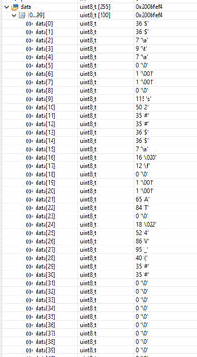

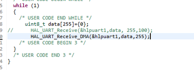

my code is in main function
when i use HAL_UART_Receive(), i can get correct data, but it has packet loss to some extend.

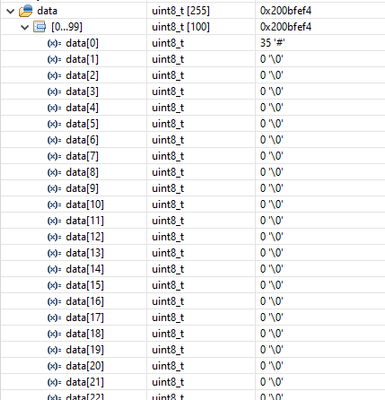

when i use HAL_UART_Receive_DMA(), i only get last byte # .

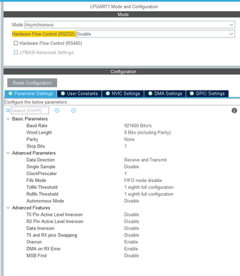

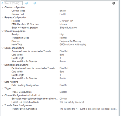

cubemx setting for DMA:
cubemx setting for usart :

Hi. Problem with DMA configuration. You must set Enabled for Destination Address Increment After Transfer.

The function returns immediately, you can't have multiple operations in flight concurrently. Manage fill of buffer in the completion callback.
Avoid using auto/local buffers for DMA, they have collapsing scope on the stack.

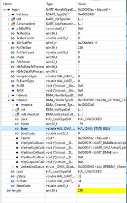

Hi, let me make the situation more clear.

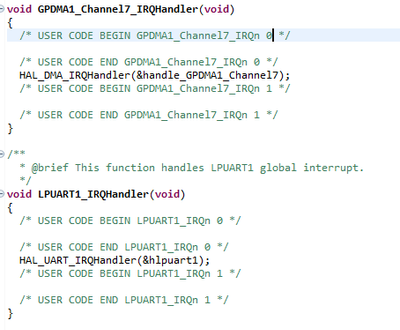

i can run into IQRHander.
i use the callback function, length=__HAL_DMA_GET_COUNTER can change. (i think MCU have known the interrupt received by usart, but dont know where to read the buffer data)
observation:
1. hdmarx state is HAL_DMA_STATE_BUSY, HAL_UART_Receive_DMA state is HAL_OK
2. pRxBuffPtr is #000....... (only first byte have data, other bytes are all 0)
3. hdmarx->init are all 0, if i set HAL_DMA_Init() in usart.c, it will into HardFault_Handler()
4. i change baud rate from 921600 to 115200, but still not work
i attach the .ioc and main.c file below.
thank you

It's not a clarity issue, its a one that lacks understanding of the mechanics
I've told you HAL_UART_Receive_DMA(&hlpuart1,data,256); returns immediately, not after you have 256 bytes, immediately.
You need some volatile semaphone coming back from the callback indicating it completed and is read for a second usage.
volatile int global_flag = 0;
while(1)
if (global_flag == 0) // nothing pending
global_flag = 1; // busy
In full completion callback
global_flag = 0;
2024-11-05 6:42 PM
Yes! thank you ,you are right!
After I set this, everything go done well.
