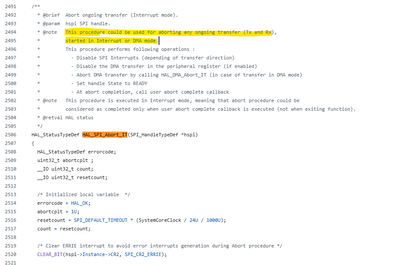

Hello @AMacd.1
The function HAL_SPI_Abort_IT() can be used to abort a transfer in interrupt or DMA mode.
Your code should be updated as below:

No, @Saket_Om.
The comment header in front of HAL_SPI_Abort() also says that this function can be used to abort a transfer in interrupt or DMA mode.
  * @brief  Abort ongoing transfer (blocking mode).
  * @PAram  hspi SPI handle.
  * @note   This procedure could be used for aborting any ongoing transfer (Tx and Rx),
  *         started in Interrupt or DMA mode.
  *         This procedure performs following operations :
  *           - Disable SPI Interrupts (depending of transfer direction)
  *           - Disable the DMA transfer in the peripheral register (if enabled)
  *           - Abort DMA transfer by calling HAL_DMA_Abort (in case of transfer in DMA mode)
  *           - Set handle State to READY
  * @note   This procedure is executed in blocking mode : when exiting function, Abort is considered as completed.
  * @retval HAL status
HAL_StatusTypeDef HAL_SPI_Abort(SPI_HandleTypeDef *hspi)
 As explained by @Pavel A., "Function HAL_SPI_Abort_IT can be called from background program or interrupt handler of a lower priority than the SPI or its DMA (to not block the SPI or DMA interrupts)." Since I am not calling from an interrupt routine or "background" program, I do not need to use HAL_SPI_Abort_IT().
Your code is no different from having the abort callback set the state to Done and just waiting for it in the switch statement. Plus you add a completely unnecessary variable.
