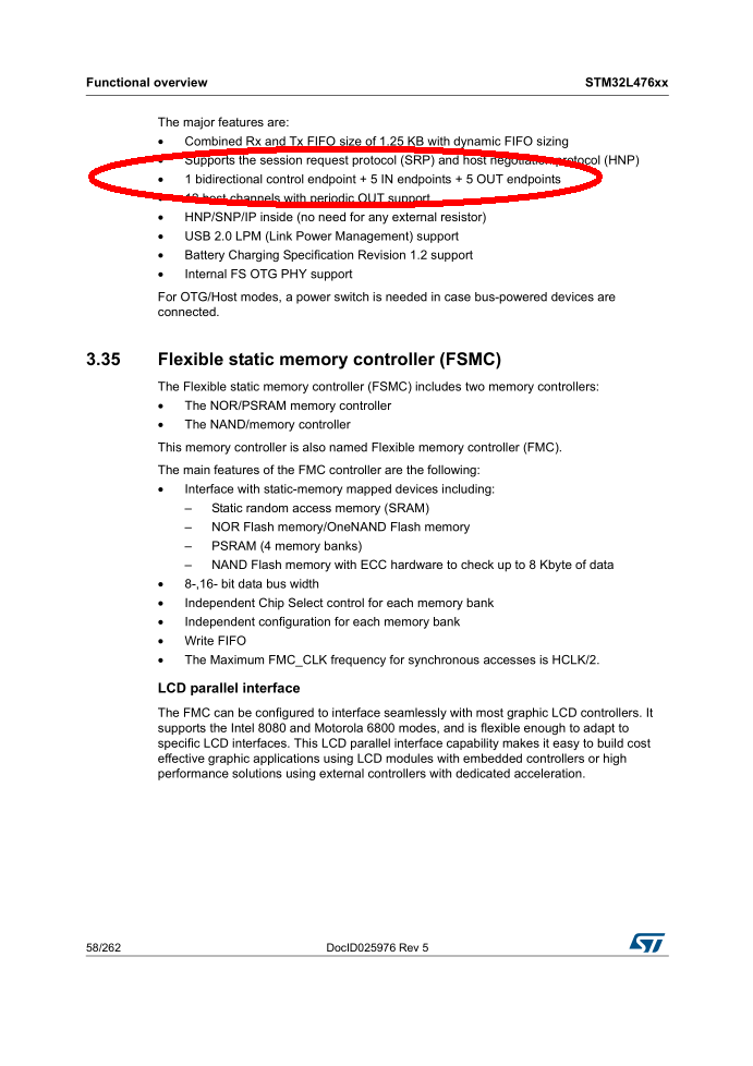

First of all, the 'L476 contains besides endpoints for EP0 only 5 IN and 5 Out endpoints, so that's probably your primary problem.
(Just a sidenote, in the mainstream 'F4xx there are two OTG modules and the OTG_HS has more endpoints).
The OTG module contains a certain amount of FIFO RAM (1.25kB for the 'L476), and you ought to tell the module how do you want to partition it, between one common Rx FIFO (common for all IN endpoints), and one FIFO for each Tx (OUT) endpoint. This is done by setting OTG_GRXFSIZ, OTG_DIEPTXF0 and OTG_DIEPTXFx registers, see description of these registers in OTG_FS registers subchapter of the OTG_FS chapter in RM. Note, all FIFO-related values are in words (how does this translate to the requirements of Cube/HAL functions, is up to you to find out). The Tx-FIFO registers generally contain not only the size of FIFO, but also its beginning, so the user can partition the FIFO in non-continuous chunks (even if this does not make much sense).

Thanks for the information. If the number of endpoints is limited to 5 IN and 5 OUT + the Control IN/OUT EP 0 if I understand well, that could explain the problems I see. I was not there when they did choose the hardware and I trying to add features into existing code.
I might need to revise my whole design. But I did not knew this limitation I knew it was 1.25 Kb RAM buffer was available, since we are using small packet for 2 interrupts (0x10 for 16 multiples each) we could still have some RAM availables for a few endpoints with each (0x40).
I did check that document:
Where is this limitation documetend? is it HAL limitation or the chip itself? I will add an assert so anybody who will try to do this on the chips will not compile anymore. We though based on this presentation from ST that we were having 8 bi-directional endpoints (16 totals) on page 3:

2019-02-27 7:59 AM
> yes we are using Stm32L476 as stated in the first message.
Sorry, I overlooked that information.
Yes, but bear in mind that the sum of Rx FIFO and all Tx FIFOs is max. 1.25kB, i.e. max. 0x140 words).
> Where is this limitation [max. number of endpoints] documetend?
and also at several places in the OTG_FS chapter in RM.
That presentation talks about the lower-end 'L4 range, see page 2. They contain an entirely different device-only USB module.
