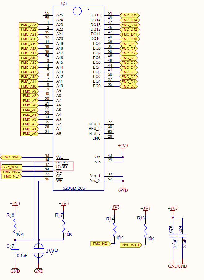

the datasheet Flash memory is

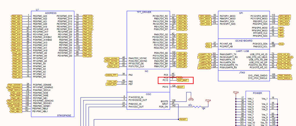

(S29GL128S). My current MCU is a SMT32F429 with a LCD. The NWAIT's pin is used by the LCD_B2 function of LCD's driver . RY/BY's signal is connected to PC13 (This pin hasn't an alternative function). My idea is manage the wait procedure implementing the HAL_NOR_MspWait function.
