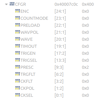

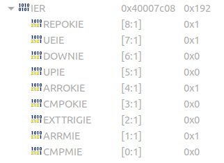

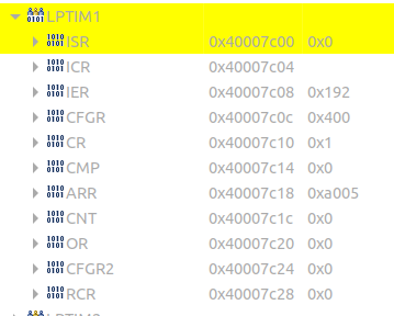

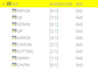

}Here are the screenshots of LPTIM registers:
Any Idea what is happening and how can I solve it?
