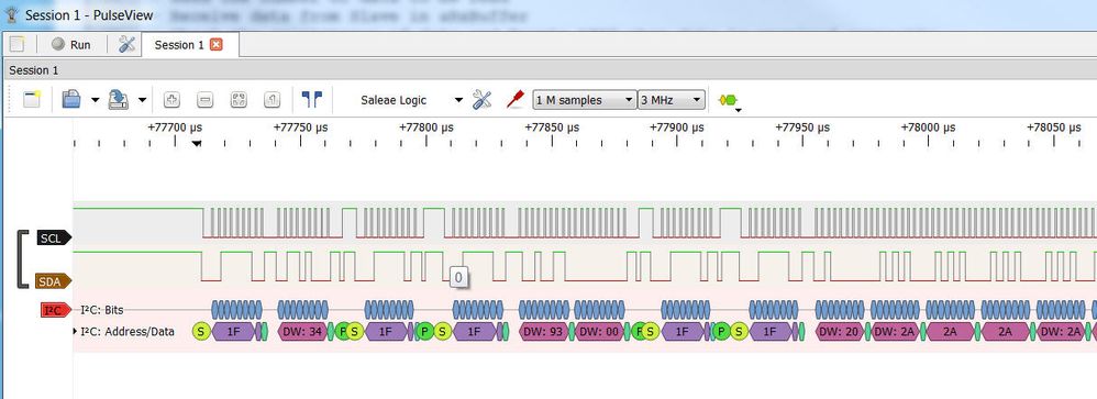

May be worth getting a logic analyzer hooked onto the bus. Below a trace of some of the master -> slave transmit data from the example.
