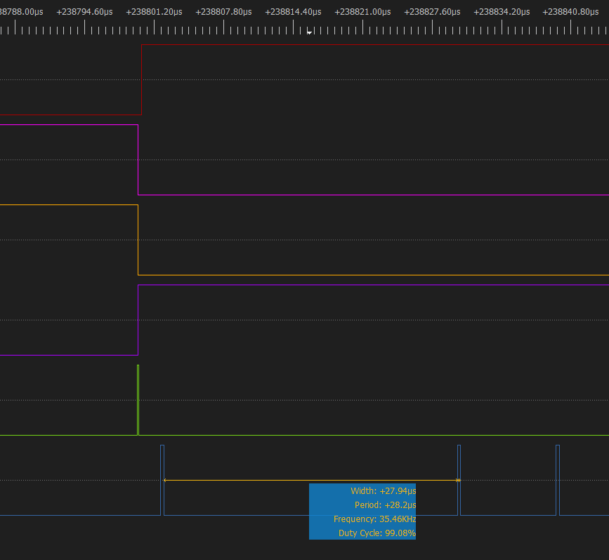

Hi. Im using HRTIM and HAL in my project.
To stop Master timer with subsequent interrupt call I use HAL_HRTIM_WaveformCounterStop_IT (it is defined in stm32_hal_legacy.h) and it calls HAL_HRTIM_WaveformCountStop_IT from stm32g4xx_hal_hrtim.c.
Pic.1 shows how long it takes to process this function call, and it is enormous 27.94us.
Yes, I know HAL is kinda slow and for maximum efficiency one should use direct registers call.
I suggest the culprit is delay inserted in this function (variable called "delai").

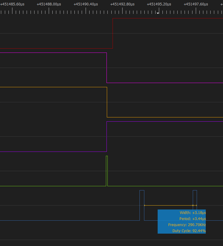

When I commented line 40
/* ++ WA */
// do { delai--; } while (delai != 0U);
/* -- WA */
