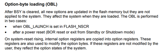

On STM32U5, the Reference manual explains the Option‑byte loading (OBL) mechanism as follows:
This means there are two distinct phases:
And the important part: OBL is tied to a reset event. When you call HAL_FLASH_OB_Launch(), the HAL sets OBL_LAUNCH, which triggers the option‑byte load sequence and the device reset.
