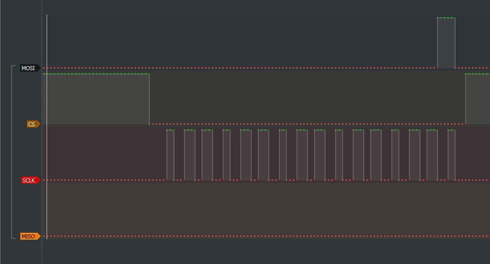

2025-11-21 3:51 AM - last edited on 2025-11-21 4:09 AM by Andrew Neil
The above image represents logic analyzer output when HAL_SPI_Receive_DMA is executed. My doubt is regarding the single high pulse at MOSI line. During HAL_SPI_Transmit_DMA , no issues. Is this normal behaviour? STM as Full duplex master, i have disconnected the slave to check if it was responsible for the high pulse.
2025-11-21 4:10 AM
Please show your code.
2025-11-21 5:28 AM - edited 2025-11-21 6:07 AM
For a Full duplex master you should always use TransmitReceive , as the SPI shifts out and in same time.
or with dma: HAL_SPI_TransmitReceive_DMA( ..)
(only receive on full duplex is like : receive and dont care about transmit... :)
It might send anything, maybe the remains from last receive, as you write nothing to send.)
2025-11-21 5:47 AM
MOSI is "Master Out Slave In".
What you see on this line is what was written by your code to the SPI Tx register beforehand.
