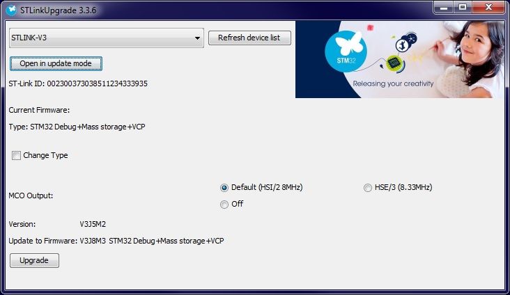

The ZI2 uses an ST-LINK/V3 so extra chances of odd clock speed settings. V3 now configurable to a broader selection of unhelpful frequencies. Don't see this well documented, but offered via the update application as I recall.
