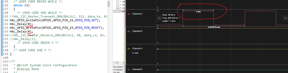

I just found out that the HAL_Delay() delay actually takes 1ms longer than the desired value. Why?
STM CUBE IDE 1.9.0
STM32F072RBT6

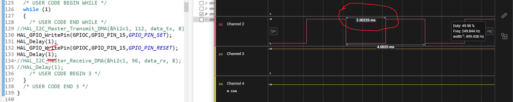

But I'm not interested in accuracy. The time is always accurate, just always +1ms, because as I found out, the function automatically increments the variable at the beginning.
__weak void HAL_Delay(uint32_t Delay)
uint32_t tickstart = HAL_GetTick();
uint32_t wait = Delay;
/* Add a freq to guarantee minimum wait */
if (wait < HAL_MAX_DELAY)// allways add uwTickFreq (1)
wait += (uint32_t)(uwTickFreq);
while((HAL_GetTick() - tickstart) < wait)
}For values in hundreds of milliseconds it is of course not important, but for 1ms it does 100%. And that caused me a problem that I only discovered by using a logic analyzer.
Of course, it is a weak function that I can override according to my needs, but I was more interested in the reason why it is so.
Sure, the comment says that it should guarantee at least a minimal delay, but it can certainly be better:
if (wait < 1)
}Or am i wrong?
