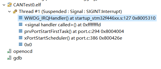

void StartDataLogTask(void const * argument){ /* USER CODE BEGIN StartDataLogTask */ if(HAL_ADC_Start_DMA(&hadc1, (uint32_t*)&uhADC_results, ADC_DATA_N) != HAL_OK) { _Error_Handler(__FILE__, __LINE__); } /* Infinite loop */ for(;;) { uint16_t str_size=sprintf(print_buff, ''t %5d : %d %d \r\n'',xTaskGetTickCount(),uhADC_results[0],uhADC_results[1]); //uint16_t str_size=strlen(print_buff); //HAL_UART_Transmit(&huart2,print_buff,strlen(print_buff),1000); while(HAL_UART_Transmit_DMA(&huart2,print_buff, str_size)!= HAL_OK){ osDelay(2); } osDelay(20); //vTaskList(print_buff); //HAL_UART_Transmit_DMA(&huart2,print_buff, 200); //osDelay(30); } /* USER CODE END StartDataLogTask */}For some reason, the code stops around 10 seconds. I have tried several things:

I do observe corruption of the default task when I debug this application, which seems to agree with what the post mentions.
So I increase stack size of all the tasks to 1024 words and now it seems to works fine.
But still I am not understanding this issue. Could someone please explain what is going on? Why is the stack of the default task that becomes relevant? And is this the right way to solve this issue?
