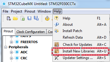

You can download the old STM32Cube firmware package from STM32CubeMx tool:
Best Regards
Imen
