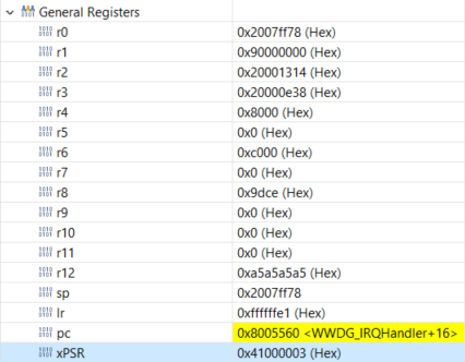

2021-12-02 8:16 PM
I've changed the code a few times since that thread, but currently SCB->INVSTATE is set.
"When this bit is set, the PC value stacked for the exception return points to the instruction that attempted the illegal use of the ESPR"
What exactly is meant by "the PC value stacked for the exception return". Stacked where? The LR register?
I'm still confused by the register values (this is at the infinite loop). I don't really trust the pc noting WWDG_IRQHandler because VECTACTIVE still stores 0x3.
I also can't use lr to see where the program crashed since it's just showing 0xffffffe1. I'm confused which register to look at to figure out where the fault was generated. And as I mentioned in the other thread, the call stack doesn't go back far enough for me to see where the fault happened.
