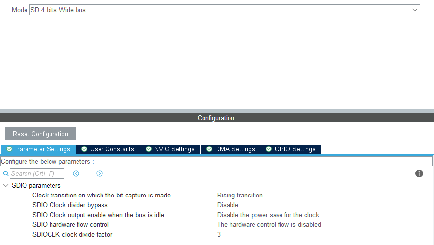

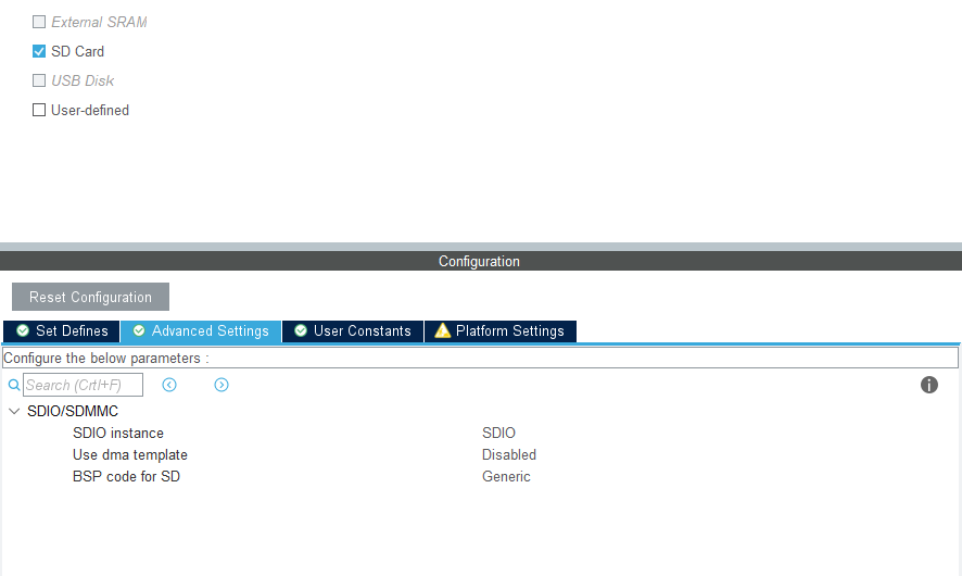

I dont use DMA, my settings
Could this be caused by the setup of CAN1/SPI3/USART2? Do they use same FIFO or something?
0693W00000FBzsVQAT.pngI have tried to increase "hsd.Init.ClockDiv", but id does not seem to solve the problem.
Could I somehow wait for FIFO to be available in my code? Is there somethink like f_waitForCompletion?
No they all have their own FIFO.
What however is critical is not to get distracted in the middle of SDIO transfers, the FIFO protects you somewhat, but you can't go off into other interrupts/threads for prolonged periods.
DMA would be preferable.
In polled you might want to look at the SDIO peripheral library, perhaps optimizing the aligned memory case, or using a "critical section"
I do SDIO write on main loop, but there are TIM2/TIM3/CAN1 RX0/CAN1 RX1 interrupts which has other logic. So those interrupts are to blame if they occur during SDIO write?
What could be the possible solution to such problem? Only reducing interrupt duration? Or would using DMA and setting all SDIO interrupts to higher priority help?
