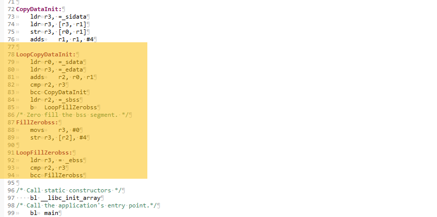

Yes, we did. Bellow there's a picture of the "location" where the problem happens.
Everything we use is only tools from ST. The yellow marked part never actually finishes, and if you have a power cycle, you don't have a problem, however, if you press reset, it will stall. So currently we perform by force a ram wipe in the startup of the first firmware during the transition to the next.

Things are still not clear (at least to me).
That code is the standard C/C++ startup code - copying intiialized variables from FLASH to RAM, then zero-ing the uninitialized variables (BSS segment). Exactly how and where is this hanging? Is it stuck in an infinite loop (somehow??????). And is the code that hangs in your pre-bootloader, bootloader or application?
And your workaround is to clear all (?) RAM on startup? In the pre-bootloader? Bootloader? App?
And just for kicks, what is connected to the CPU's NRST line on the PCB? Is there anything that would prevent the CPU from driving that line low?
