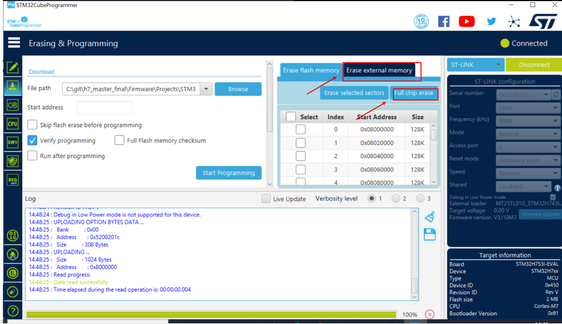

Hello @Shikamaru ,
you can use STM32CubeProgrammer , it is an excellent tool for programming and erasing internal & external flash memory. Here’s how you can use it to perform a mass erase and format the external flash:
Download and Install STM32CubeProgrammer:
Connect Your Microcontroller:
Open STM32CubeProgrammer:
Select the Target:
Mass Erase:
