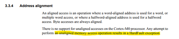

In Cortex-M0 and Cortex-M0+ processors, unaligned access does not occur naturally, as described in the ARM Cortex-M0 user guide:
To address alignment issues, changing the configuration from CRC_INPUTDATA_FORMAT_WORDS to CRC_INPUTDATA_FORMAT_BYTES solves the problem. This approach copies data byte by byte to the CRC DR, ensuring proper alignment. However, it may result in increased write cycles for longer buffers, leading to higher computation times.
For the second suggestion, report unaligned buffers as a HAL_ERROR. The issue with unaligned buffers is that the API might mask a potential HardFault, which could hinder debugging efforts if this HardFault arises later.
Therefore, the recommended approach is to use a temporary container with the memcpy() function to align data before processing it with CRC.
