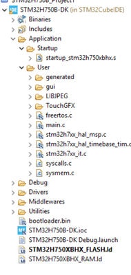

Looking at the STM32H750-DK code which I have working with TouchGFX.
The structure of all the user code is under 'Application'. Could I use the exact same Bootloader.bin file and develop the 'Application' code of my custom PCB around this structure?

Please read the read me file of ExtMem_Boot:
Define "CODE_AREA" , "DATA_AREA" and "BINARY_AREA" in file memory.h are used respectively to select the Code execution area, the application data area and the binary storage area. The ExtMem_Boot program is located at 0x08000000 (Internal flash).

My confusion here is how bootloader.bin is generated and linked to the ExtMem_Boot section of the code.
I get the ExtMem_Boot code will have to be modified as the pinout is different, but doesn't the bootloader.bin file need to be regenerated for the modified ExtMem_Boot code -> hence the IAR would be needed to regenerate this file.
