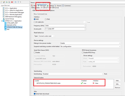

Add that flash loader in the Debugger/ External loaders:
2026-02-05 7:28 AM - edited 2026-02-05 7:31 AM
I have done that. I have created the 'External Loader' and I have proven it works and writes/reads to QUADSPI at memory region 0x90000000, using STM32CubeProgrammer. As shown in the Youtube tutorial.
I then added it to STM32CubeIDE

ExtMem_Boot does not exist in my TouchGFX project that I created from a blank STM32CubeIDE Project.
2026-02-05 7:31 AM
I know its the linker script which is the last step here in getting it working.
2026-02-05 7:38 AM
.bootloader :
. = ALIGN(4);
ExtMem_Boot/bootloader.o(*)
} >BOOTLOADER
That 's a boot application that boots from the internal Flash. The application is mapped at the external QSPI Flash.
So you need to develop that loader by inspiring from the example provided here: https://github.com/STMicroelectronics/STM32CubeH7/tree/master/Projects/STM32H750B-DK/Templates/ExtMem_Boot/Src
So after reset, the MCU boots from the internal flash then the loader gives the stage to the application that jumps to the external memory.
