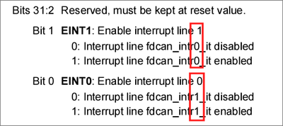

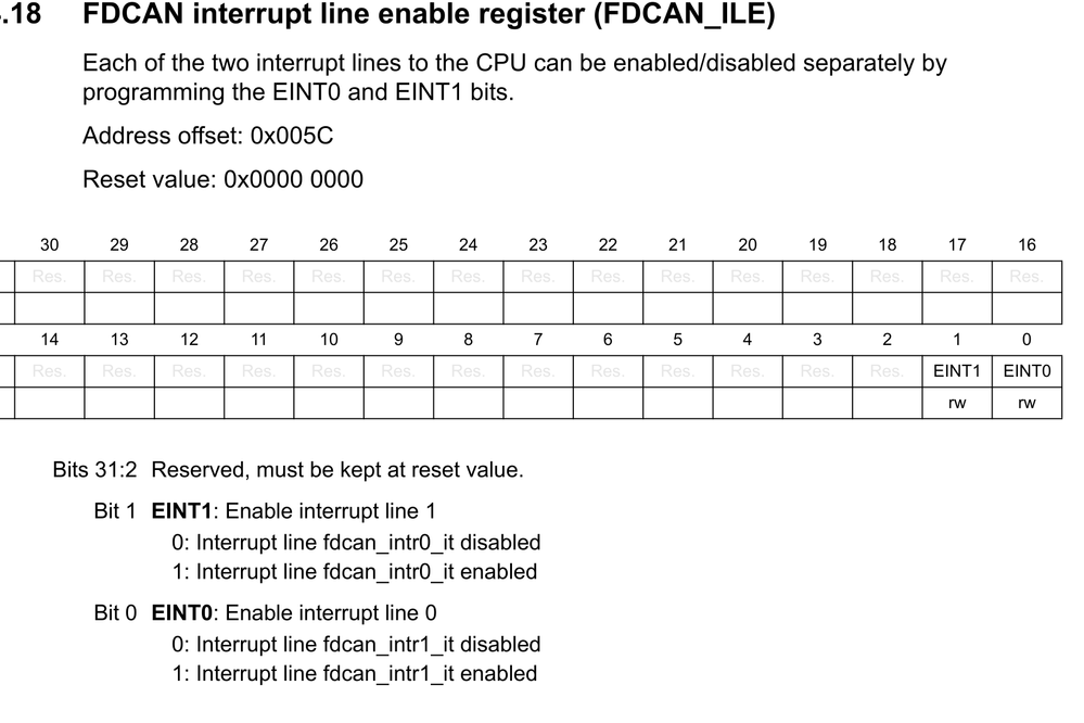

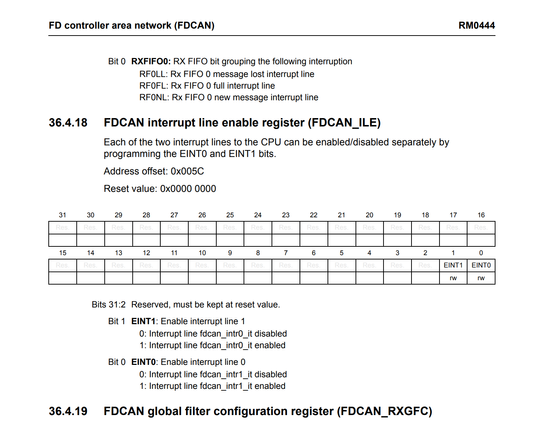

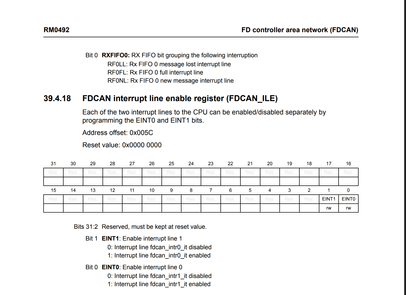

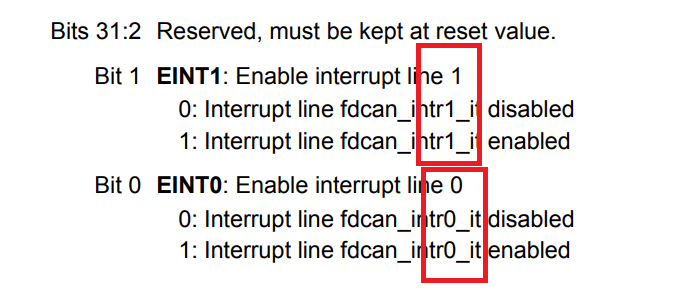

2026-02-28 2:28 PM - edited 2026-02-28 2:30 PM
Hello Elmü
You were right, it’s just a *** typo in the RM for G0, G4, and H5 — a classic copy-paste error. I actually found an old project where I misconfigured FDCAN1->ILS and forgot about it, but it stuck in my head as if it were some "special feature" of that chip )).
I wrote some nonsense here, but the most important thing is to admit the mistake rather than just arguing forever )).
I rewrote the test code from scratch and verified everything: it works exactly the same way as on the H7 )))

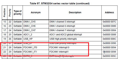

2025-01-28 7:27 AM - edited 2025-01-28 7:46 AM
I didn't understand how you arrived to the conclusion that the IRQ vector table needs to be in this order:
FDCAN1_IT1_IRQHandler
FDCAN1_IT0_IRQHandler
Instead of :
According to the reference manual RM0440 / Table 97. STM32G4 series vector table ,the implemented order is correct:
I invite you to use the HAL to confirm your observation instead of playing with the direct access to the registers.

FDCAN interrupt line enable register (FDCAN_ILE)
Bit 1 EINT1: Enable interrupt line 1
0: Interrupt line fdcan_intr0_it disabled
1: Interrupt line fdcan_intr0_it enabled
Bit 0 EINT0: Enable interrupt line 0
0: Interrupt line fdcan_intr1_it disabled
1: Interrupt line fdcan_intr1_it enabled

What you mean is this on page 2001 of the RM0440:
But to me this seem to be a typo in the manual.
Did you test this in the real world, or do you blindly trust the manual ?

This is not an error, but an attempt to align the logic for the G4 series )
NVIC_EnableIRQ(FDCAN1_IT0_IRQn); // Enables FIFO 1 interrupt
NVIC_EnableIRQ(FDCAN1_IT1_IRQn); // Enables FIFO 0 interrupt
void FDCAN1_IT1_IRQHandler(void) {} // Handles Message FIFO 0
void FDCAN1_IT0_IRQHandler(void) {} // Handles Message FIFO 1
You just have to keep this in mind or be aware of it.)))

Hello Elmue,
I would like to draw your attention to the fact that the FDCAN core in the STM32H7 is a more complete version.
In the STM32G4 and STM32G01 series, it is a stripped-down (truncated) version.
(Perhaps that's the story here — someone "trimmed" it a bit carelessly :) just kidding).
However, if we look at the RM (Reference Manual) for the STM32G01, we see the exact same register — do you think that's a typo there as well?
You won't deny that
this can be verified)
Following the logic of the same FDCAN_ILS register
bit 0 - corresponds to FIFO0
The same applies to FDCAN_ILE
What confuses you
NVIC_EnableIRQ(FDCAN1_IT1_IRQn) == Interrupt line fdcan_intr1_ITenabled
It's strange, but it is what it is. (this is related to the definitions in the interrupt vector files)
The same FDCAN core as on the STM32H503 RM0492
Hello Elmü
