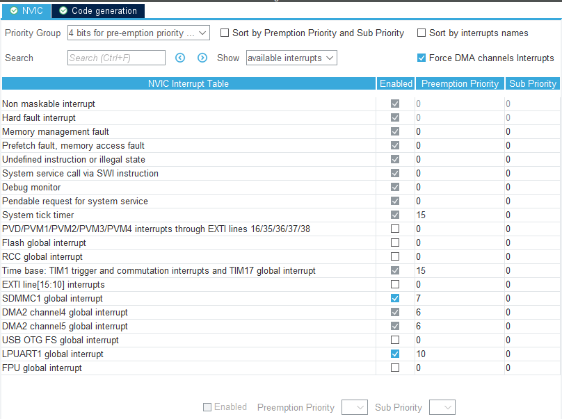

Do these interrupt priorities seem reasonable?
NVIC Interrupt Table Enabled Preemption Priority Sub Priority

SDMMC1 global interrupt TRUE 7 0
DMA2 channel4 global interrupt TRUE 6 0
DMA2 channel5 global interrupt TRUE 6 0
USB OTG FS global interrupt FALSE 0 0
LPUART1 global interrupt TRUE 10 0
FPU global interrupt FALSE 0 0 In case that's too hard to read:
2022-04-11 2:50 PM
Look to be reasonable.
