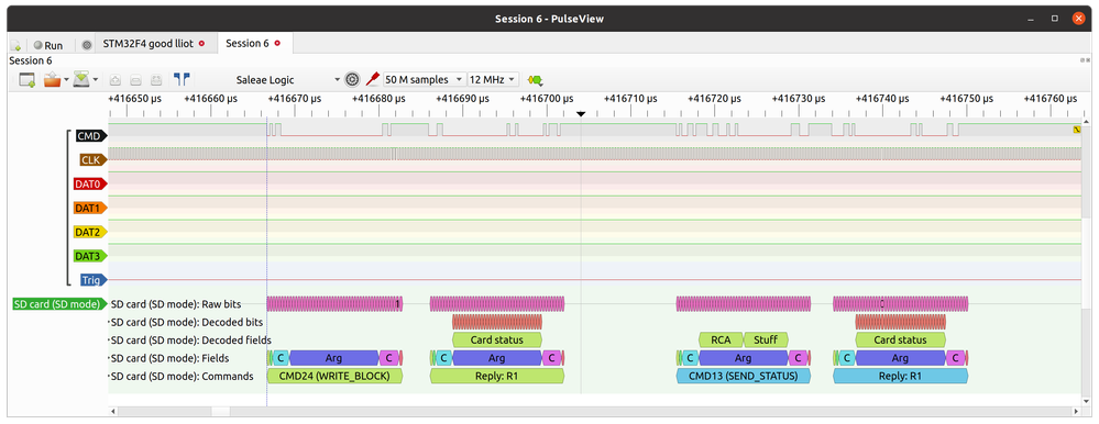

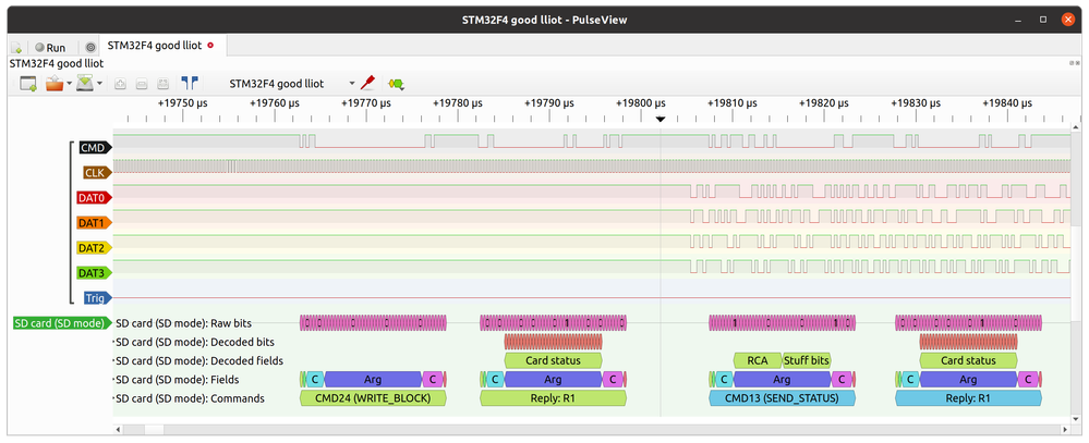

On the NUCLEO-F413ZH, here's what I see with a logic analyzer on the SD bus when I call HAL_SD_WriteBlocks_DMA:

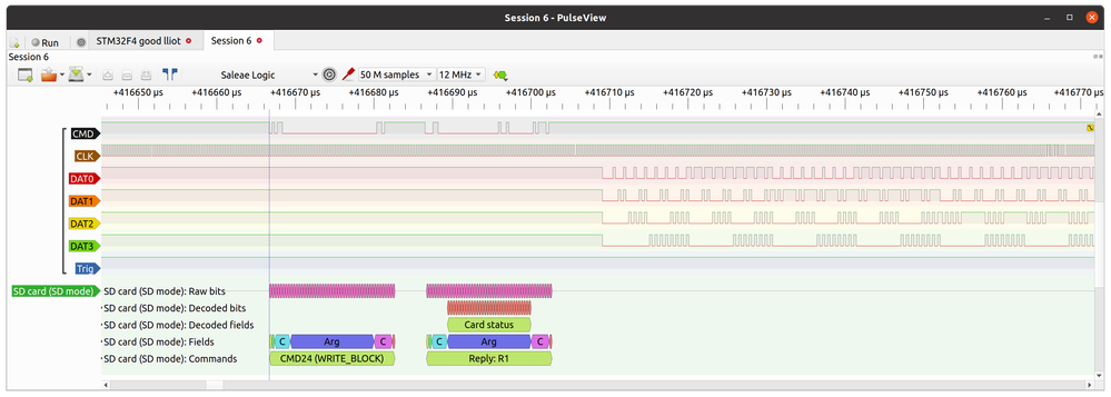

On the NUCLEO-L4A6ZG, here's what I see with a logic analyzer on the SD bus when I call HAL_SD_WriteBlocks_DMA:
There is no activity at all on the data lines!
Now, again on NUCLEO-L4A6ZG, if I simply change HAL_SD_WriteBlocks_DMA to HAL_SD_WriteBlocks, I get this:
So, when I call HAL_SD_WriteBlocks_DMA on the L4A6ZG, the command is sent but no data is ever sent.
