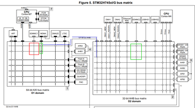

Hi @Legacy member,
Looking at the STM32H745XX datasheet https://www.st.com/resource/en/datasheet/stm32h745zg.pdf
you can find the bus matrix description in the page 30.
As you can notice above SDMMC1/DMA does not have access to the Domain2 SRAMx memories as it is not connected to the D1/D2 AHB bus. it can only access the AXI SRAM in D1, same applies for SDMMC2 in the D2 that can't access the AXI SRAM in D1 but only the SRAM1, SRAM2 and SRAM3.
So to use DMA within SDMMC either work with CM7 & SDMMC1 or CM4 & SDMMC2.
otherwise you'll need to use polling mode.
